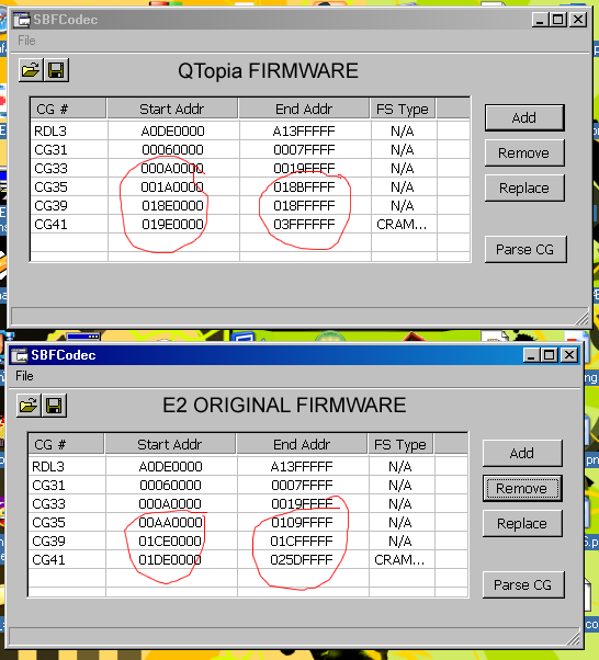

Nsolares, u are the bicyclist biggrin.gif when u flash phone with full-flash file, first rdl erase all mtd partitions, and then flash it. nothing new, just time spent in vain
Добавлено позже (24.10.2008, 11:02):
>>what is in this FW?
only RDL and 5 empty CG's. Ъ bicycle

hi, the secret of my modded Firmware is really basic....I take the update version of QTopia FW...... then in a hexeditor, I modified all cg's, the original cg's then a replaced all bit from every CG to only FF biggrin.gif
This make a FULL CLEAN. all parts of QTopia FIRMWARE. hehehe really easy right? biggrin.gif well, then your phone is empty....and you can flash with other FULL MONSTER.
If you don't understand me, you can open the .sbf file, and check all cg's. biggrin.gif
I hope it make your ROKR E2 ALIVE.
tmp_do: If you flash a FULL FLASH file for E2, it does not works, because it does not make a full clean, For that reason I replaced all cg's to FF from the orignal addres of QTopia FW. The original addres of E2 (CGs) are different to the QTopia FW. Check the addres start and end. thumbsup.gif
take a look the screenshot.
