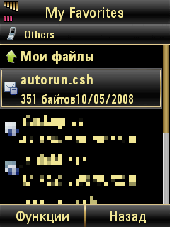

autorun.csh exists?

QUOTE(TEQUILA @ 11.6.2008, 6:30) *
anhvu2875,
And, check your /Others
autorun.csh exists?
TEQUILA : i dont have that ( autorun.csh ) , where can i get it ??! ((
and i need to up that file to '' Others '' folder where '' Start.html '' was in : My Favorites / Others ??
THANKS !

TEQUILA   anhvu2875, check post#1 :) And, check your /Othe...   11.6.2008, 6:30
anhvu2875   [b]anhvu2875, check post#1 :) And, check your /...   11.6.2008, 6:46
TEQUILA   anhvu2875, here (in jaidaid.tar.gz) or there Bu...   11.6.2008, 8:00
anhvu2875   [b]anhvu2875, here (in jaidaid.tar.gz) or there ...   11.6.2008, 8:06
TEQUILA   anhvu2875, run "cmd". Enter "telne...   11.6.2008, 10:45
anhvu2875   [b]anhvu2875, run "cmd". Enter "t...   11.6.2008, 13:11
