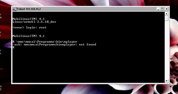

anhvu2875,
run "cmd". Enter "telnet 192.168.16.2"
username - "root"
enter "/mmc/mmca1/Programms/bin/mplayer" program must write some info
then enter "/mmc/mmca1/Programms/bin/mplayer /mmc/mmca/Videos/videofilename.3gp" and watch the screen

QUOTE(TEQUILA @ 11.6.2008, 10:45) *
anhvu2875,
username - "root"
enter "\mmc\mmca1\Programms\bin\mplayer" program must write some info
then enter "\mmc\mmca1\Programms\bin\mplayer \mmc\mmca\Videos\videofilename.3gp" and watch the screen
TEQUILA
i just can see this :
IPB Image

TEQUILA   Blad790, попробуй так: mount -o remount,rw,exec -...   8.6.2008, 18:02

Abram   Try pressing TAB in the middle of the word, maybe...   11.6.2008, 23:07
anhvu2875   Try pressing TAB in the middle of the word, maybe...   11.6.2008, 23:10
Abram   Looks like bad/broken binary, file system of micr...   11.6.2008, 23:17
anhvu2875   Looks like bad/broken binary, file system of micr...   11.6.2008, 23:43
Abram   backup it ;). also try replacing just the files y...   11.6.2008, 23:48
puneet6093   Abram I am also having the same problem. Plz help....   12.6.2008, 7:19
anhvu2875   Abram : yes it worked , but my phone hang when i t...   12.6.2008, 10:52
puneet6093   Anhvu mine is working now. As told by abram i form...   12.6.2008, 12:24
