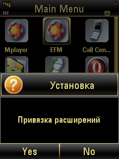

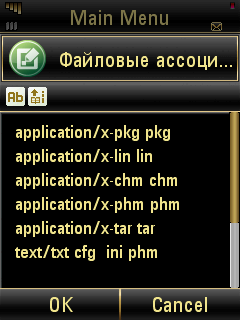

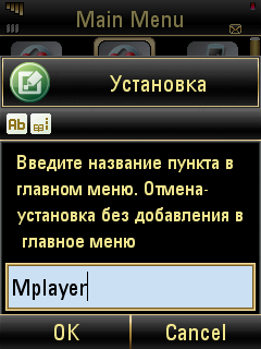

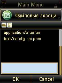

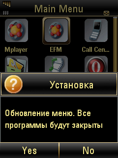

TEQUILA : i flashed back to Linuxmod3
these are the things i saw as creating EFM and Mplayer via EFM :
IPB Image > IPB Image > IPB ImageIPB Image
> IPB Image
After that i cant run Mplayer , press it and nothing happen ?? (

anhvu2875   TEQUILA : i flashed back to Linuxmod3 these are t...   11.6.2008, 13:50
