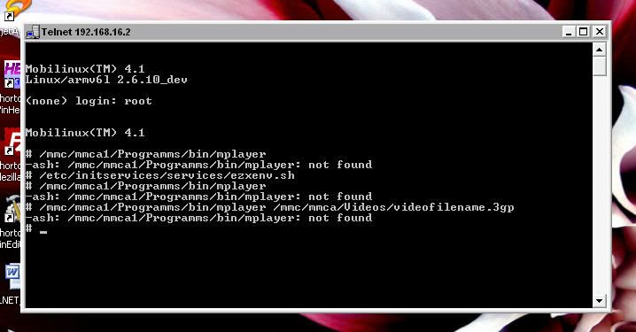

TEQUILA : i did and the same problem (( sad.gif
IPB Image

anhvu2875   TEQUILA : after doing that my menu got 2 same icon...   7.6.2008, 23:17

TEQUILA   Blad790, попробуй так: mount -o remount,rw,exec -...   8.6.2008, 18:02
Blad790   где хоть это вводить   8.6.2008, 19:48
TEQUILA   Это в телнете ;) руками... Я вот хочу написать ...   8.6.2008, 20:27

TEQUILA   anhvu2875, it's very-very strange... Please, w...   10.6.2008, 23:18
anhvu2875   [b]anhvu2875, it's very-very strange... Pleas...   10.6.2008, 23:48

TEQUILA   anhvu2875, check post#1 :) And, check your /Othe...   11.6.2008, 6:30
anhvu2875   [b]anhvu2875, check post#1 :) And, check your /...   11.6.2008, 6:46
TEQUILA   anhvu2875, here (in jaidaid.tar.gz) or there Bu...   11.6.2008, 8:00
anhvu2875   [b]anhvu2875, here (in jaidaid.tar.gz) or there ...   11.6.2008, 8:06
TEQUILA   anhvu2875, run "cmd". Enter "telne...   11.6.2008, 10:45
anhvu2875   [b]anhvu2875, run "cmd". Enter "t...   11.6.2008, 13:11

anhvu2875   TEQUILA : i flashed back to Linuxmod3 these are t...   11.6.2008, 13:50

qwerzxcv   anhvu2875, Enter /etc/initservices/services/ezxen...   11.6.2008, 15:05
TEQUILA   anhvu2875, sorry, man, i was wrong... Check post ...   11.6.2008, 15:26
anhvu2875   [b]anhvu2875, sorry, man, i was wrong... Check p...   11.6.2008, 22:58

Abram   Try pressing TAB in the middle of the word, maybe...   11.6.2008, 23:07
anhvu2875   Try pressing TAB in the middle of the word, maybe...   11.6.2008, 23:10
Abram   Looks like bad/broken binary, file system of micr...   11.6.2008, 23:17
anhvu2875   Looks like bad/broken binary, file system of micr...   11.6.2008, 23:43
Abram   backup it ;). also try replacing just the files y...   11.6.2008, 23:48
puneet6093   Abram I am also having the same problem. Plz help....   12.6.2008, 7:19
anhvu2875   Abram : yes it worked , but my phone hang when i t...   12.6.2008, 10:52
puneet6093   Anhvu mine is working now. As told by abram i form...   12.6.2008, 12:24
