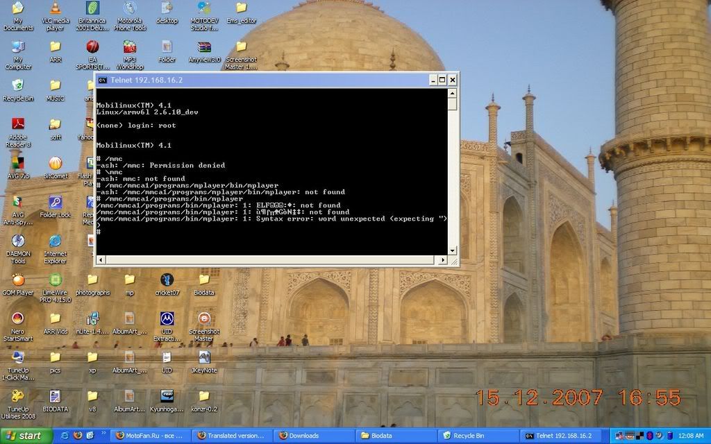

puneet6093
сообщение 12.6.2008, 7:19
Регистрация: 12.6.2008
Пользователь №: 174 735
Модель телефона: Razr 2 v8
Abram I am also having the same problem.
Plz help...

Abram   Try pressing TAB in the middle of the word, maybe...   11.6.2008, 23:07
anhvu2875   Try pressing TAB in the middle of the word, maybe...   11.6.2008, 23:10
Abram   Looks like bad/broken binary, file system of micr...   11.6.2008, 23:17
anhvu2875   Looks like bad/broken binary, file system of micr...   11.6.2008, 23:43
Abram   backup it ;). also try replacing just the files y...   11.6.2008, 23:48
puneet6093   Abram I am also having the same problem. Plz help....   12.6.2008, 7:19
anhvu2875   Abram : yes it worked , but my phone hang when i t...   12.6.2008, 10:52
puneet6093   Anhvu mine is working now. As told by abram i form...   12.6.2008, 12:24
