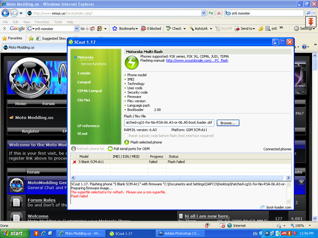

сообщение 24.9.2009, 16:58
Регистрация: 10.9.2009
Пользователь №: 206 041
Модель телефона: qqqwww
Already : my phone not conect to pc.
by testpoint method erase flash by ramldr.
now : my phone conect to pc S Blank SCM-A11
But error flash fail.
please help me.
thank you.

maniii   Already : my phone not conect to pc. by testpoint...   24.9.2009, 16:58
yakk   maniii What was with your phone before you've ...   24.9.2009, 17:42
