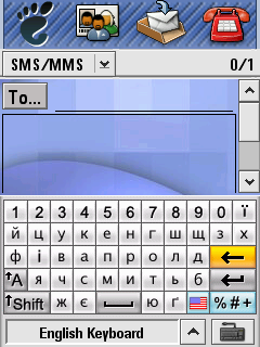

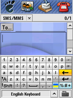

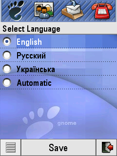

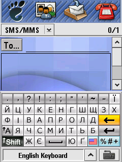

linuxoid200, Hi
If this is okay I can update (or you want the Ukrainian keyboard alone?).
I attach the files (remove greek string if not enough space).
p.s.: Please let me know if correct (I do not understand Russian and Ukrainian)
Сообщение отредактировал marcolnx - 4.5.2010, 20:06
