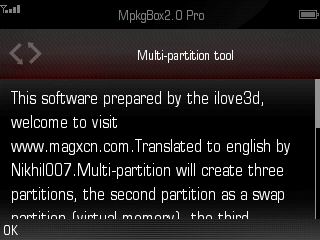

Preface:
MOTOMAGX platform for the various models in the ilove3d's efforts have largely achieved MGX installation of software and MGS theme
Also achieved a very convenient for the font mounted
However, there has been very good to solve a problem, when using the font mounted or MGS theme, USB memory card mode then the computer will crash
Open MGX virtual memory is also true
This software can solve this problem

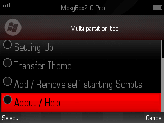

It is divided into three areas TF Card
1 District: still FAT32 format, and usually the same as
Zone 2: swap partition for virtual memory
Zone 3: EXT3 storage area, used to store themes, fonts, etc.
Set partition:
Within a certain range you can choose what you want size 2 and 3.
Transfer Subject:
Click on the theme of MGS after installation can be transferred to the EXT3 partition where
Ie / ezxlocal / download / mystuff / skins transferred to / mmc/ext3/skins
(Theme authors can continue to use the path in front of the transfer process will automatically replace the path)
Other mount:
Fonts
/ mmc/ext3/myfont.ttf
/ mmc/ext3/mynum.ttf
Switch machine animation
/ mmc/ext3/poweron.gif
/ mmc/ext3/poweroff.gif
Switching the sound
/ mmc/ext3/poweron.wav
/ mmc/ext3/poweroff.wav

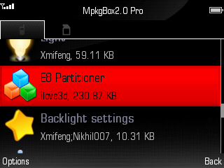

Zorge.R   Сборка от ilove3d, заточена под его моды. Поэтому ...   5.10.2009, 17:02
kale   у меня незапускается(((( ставлю всё правильно врод...   5.10.2009, 19:42
Zorge.R   вот свежая сборка, со встроенными шоу модулями (...   5.10.2009, 21:14

Zorge.R   надо скрипт добавить в автозапуск, иначе будешь...   7.10.2009, 0:14
kale   как добавить в авторан??) и после этой фигни у мен...   7.10.2009, 13:05
Zorge.R   там кнопка есть add \ remove script. после ...   7.10.2009, 13:07
