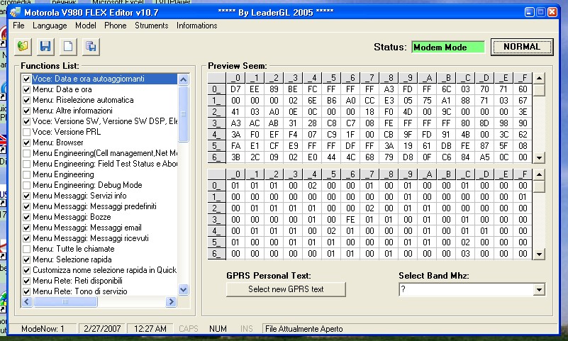

I`ve got LeaderGL_FlexEditor and check in all the boxes, save on phone and restart. Then ... now too sad.gif there is no network, i can`t access any of the menus, can`t reset ot Master clear. I cant switch to Normal mode in the program and just... don`t know what to do.
There is a pic of the displey now:
there is some strange icon, who wasn`t there before...

Icon--this is AGPS (AGPS does not work at V980).
In LeaderGL FlexEditor switch off menu:AGPS
U can try make reflash. What firmware in phone(see in flashmode)?

you got to be kiddin.... i`ve got mot v980 until yesterday, now i have an unsoported icon? blink.gif clap.gif
how to switch? the button doesn't work and i can`t find it from the menu.. sad.gif
When i click on NORMAL buton to switch there`s happend nothing blink.gif i just can`t switch, it`s allways MODEM MODE zoo_taz.gif
