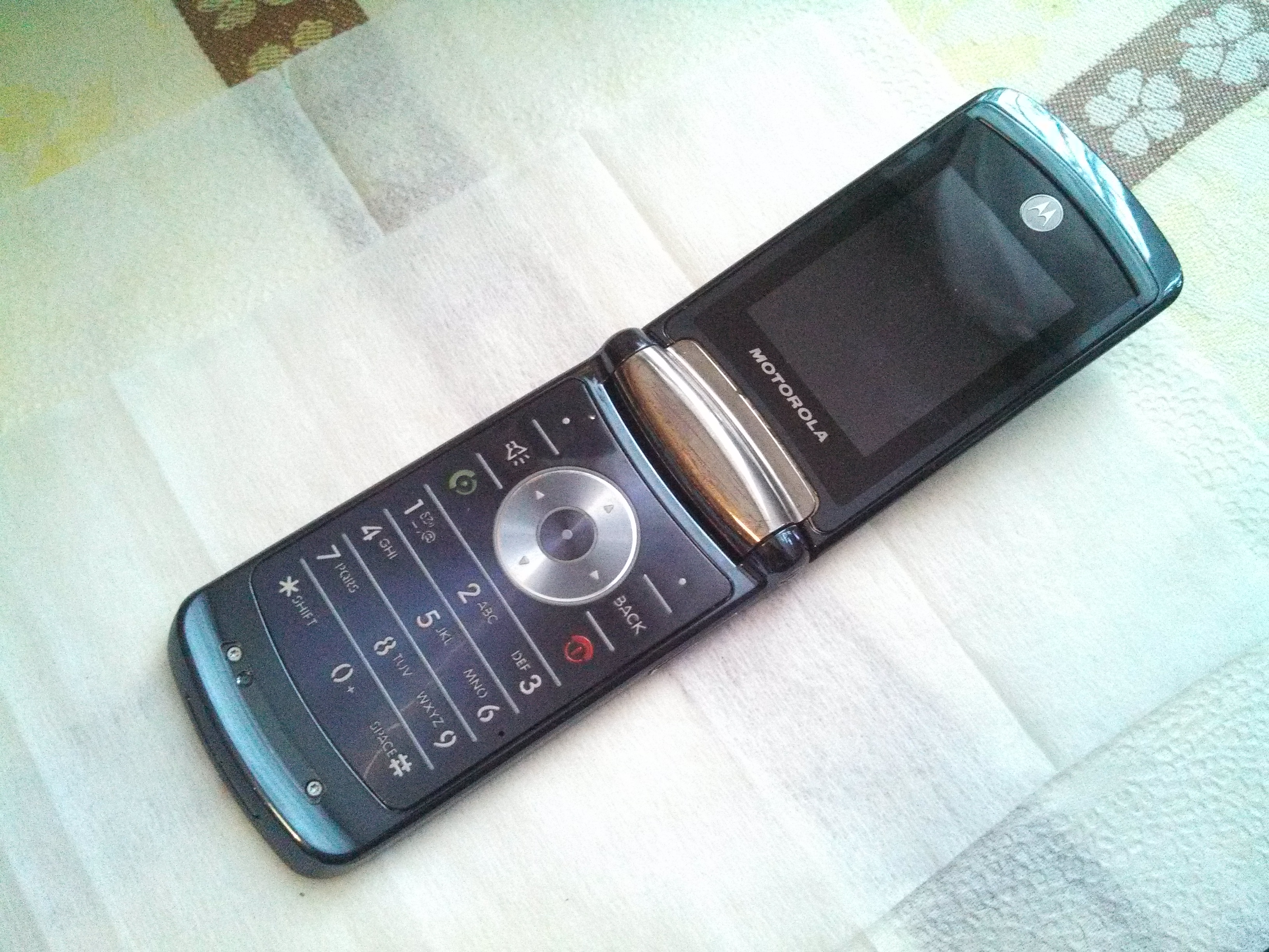

Good luck! The RAZR² V8 Luxury Edition is a very cool design phone!
Photos by Sergey Svetlitsyn.
Be careful with flashing it, V8 LE also has a lot of locked firmware.

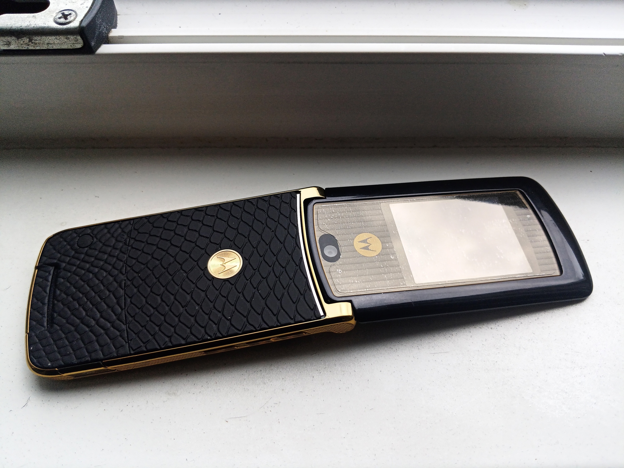

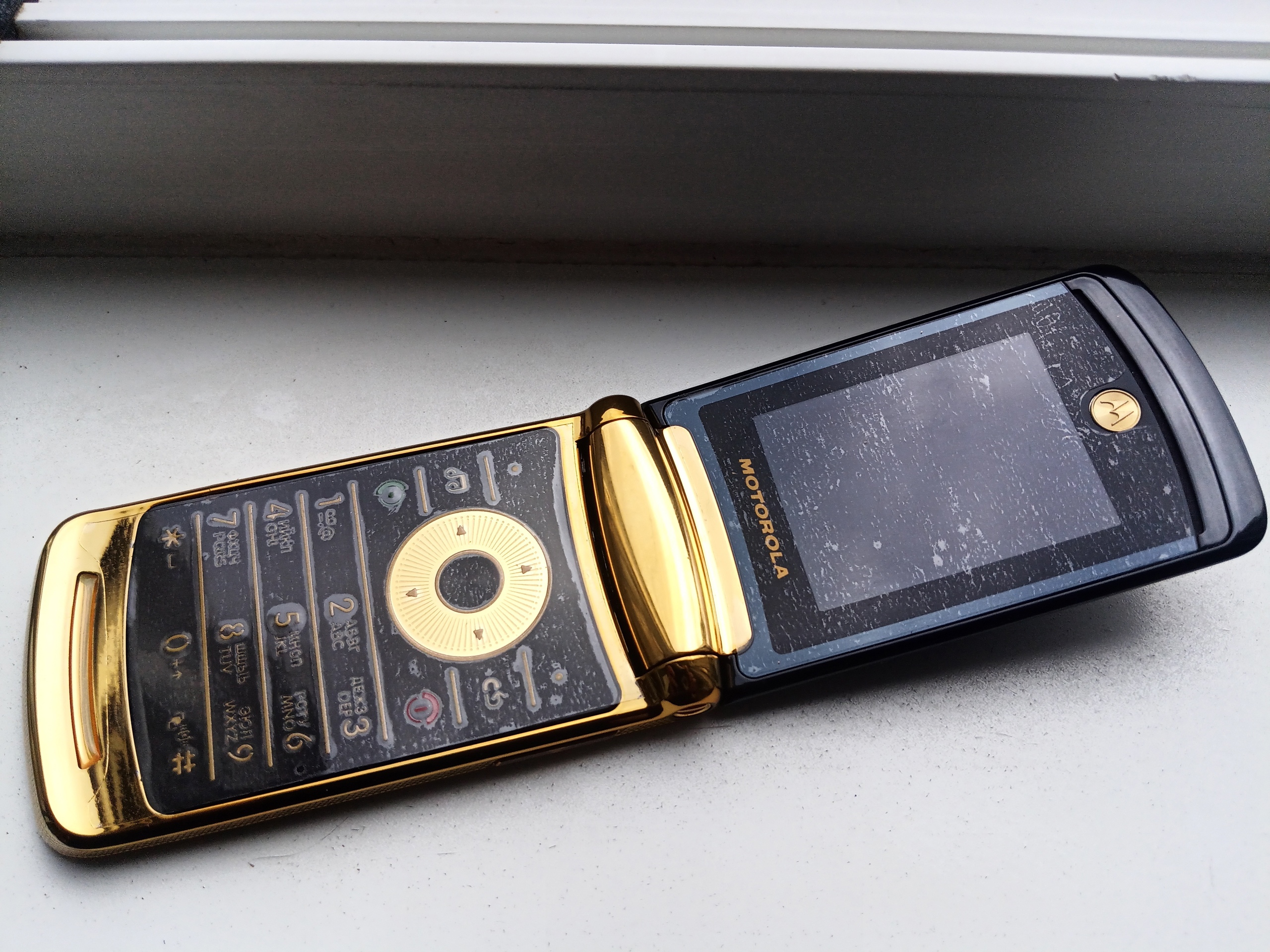

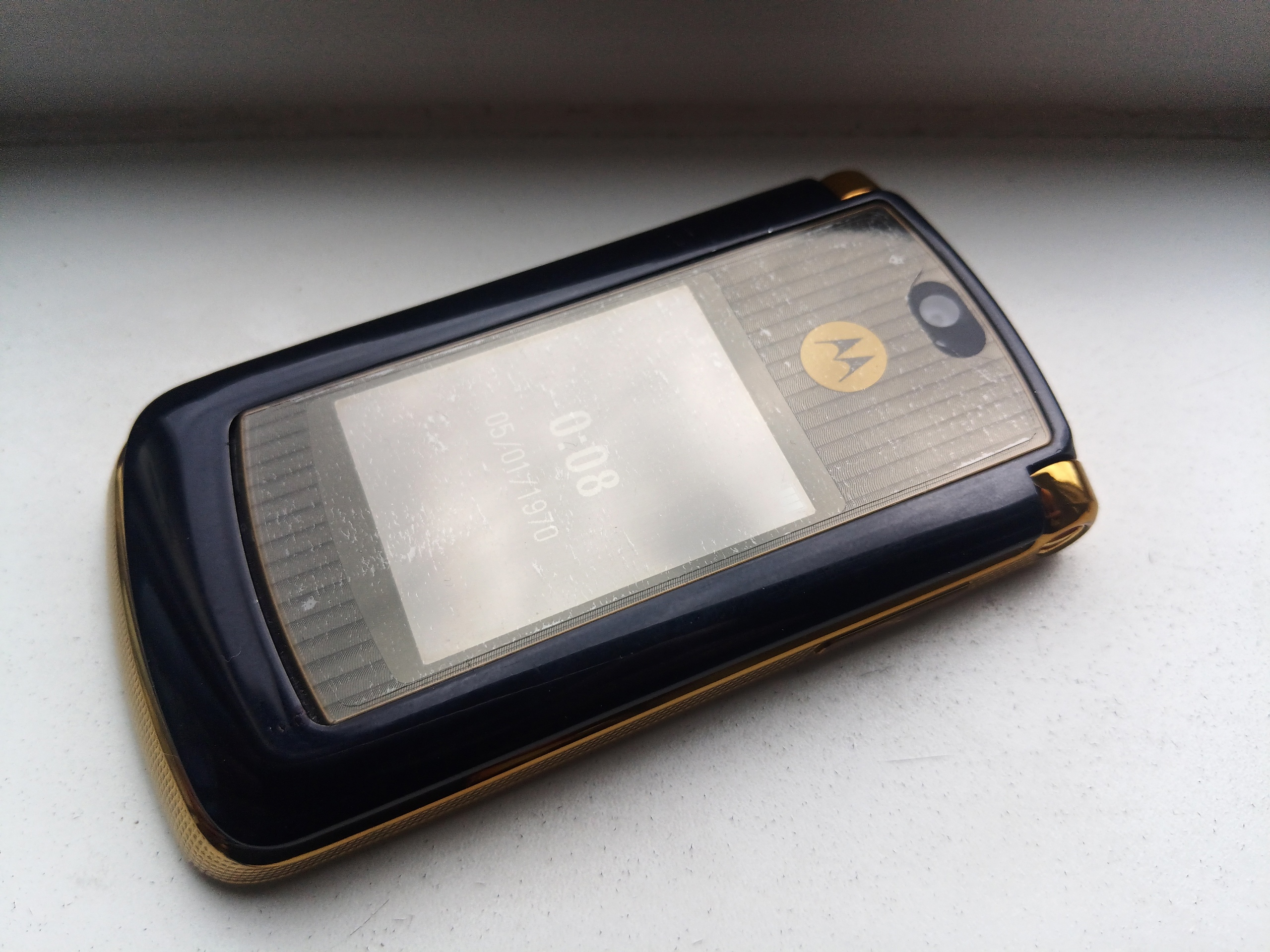

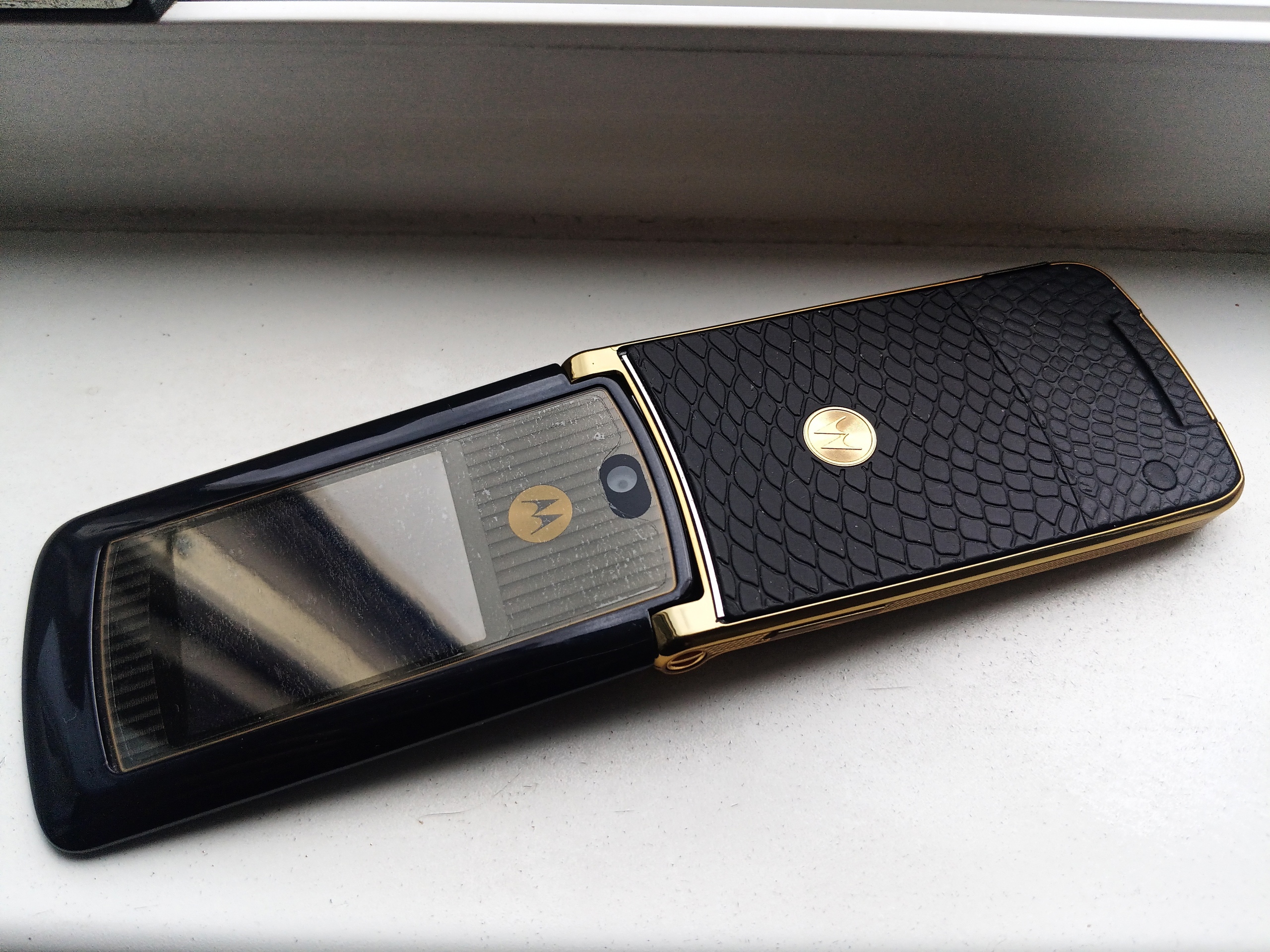

@EXL
Hello again!
I am back with a finally found V8 Luxury Edition in good condition.
However I noticed that the software is quite buggy and I want to update it.
As far as I know, the Luxury Edition was only available for retail market, right? Therefore there must be a safe and unlocked firmware for the phone right?
Thank you!
malek79
сообщение 21.8.2023, 13:58
Сообщений: 45
Регистрация: 16.6.2023
Пользователь №: 254 009
Модель телефона: Razr² V8
The firmware installed on the phone is: R601_8.54.5DR_A
The bootloader version is: A3.CD
What do you think?

malek79,
Hello!
Цитата(malek79 @ Сегодня, 20:53)
* As far as I know, the Luxury Edition was only available for retail market, right? Therefore there must be a safe and unlocked firmware for the phone right?
It's impossible to say for sure for some unknown firmware, unfortunately. SBF-Recalc has a SIM-Lock removal feature for any firmware but this will require some "not-so-obvious" manipulations.
There is a firmware for RAZR V8 2GB Luxury Edition that was flashed by forum users and it should be 100% without SIM-Lock, discussion here: Нужна прошивка к V8 с золотыми аналоговыми часами
I would do the following in your situation:
1. Сharge battery to 100%.
2. Switch to bootloader mode by pressing *, #, Red buttons together when phone is powered off.
3. Flash it from A3.CD to A3.CF bootloader using RSD Lite 3.8
4. Flash it to R601_G_80.56.15R_GSQLIDO2GBLUXAPMY084 firmware using RSD Lite 3.8
R601_G_80.56.15R is newer than R601_8.54.5DR_A many bugs can be fixed there.
