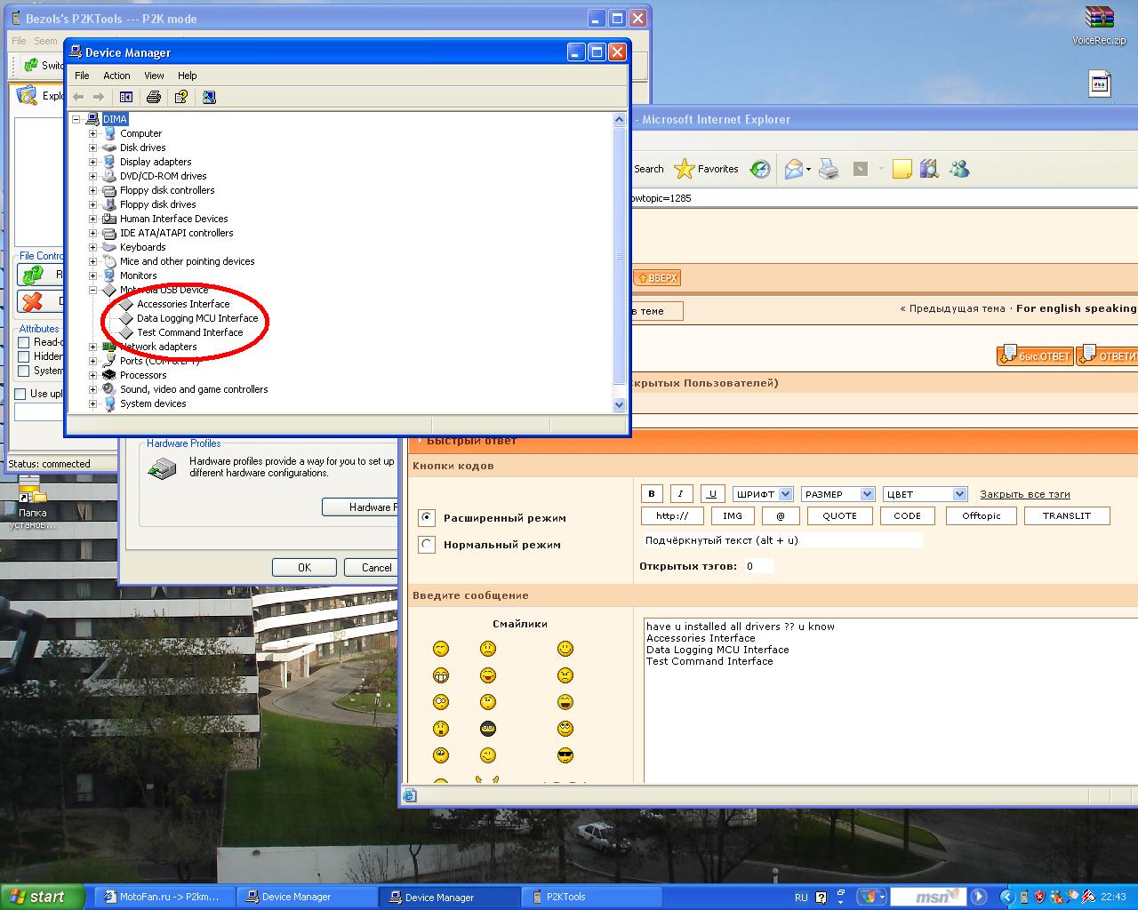

have u installed all drivers ?? you know
Accessories Interface
Test Command Interface
Data Logging MCU Interface
if not ,open P2kTools choose P2kmode then you gonna hear sound when you connect any Usb devices (you phone have to connected)
then click Start button after that choose my computer press it with right button on the mouse and then choose "properties"
after you do that go to "hardware" and then click on "device manager" button after that u ll see all devices that are installed on ur computer ,find "Motorola USB Devices" if u can't see it repeat all steps with P2kTools and try to go into "Device Manager"
ok if you see "Other devices" label then click on it and you'll see Those labels "Accessories Interface",
"Data Logging MCU Interface" ,"Test Command Interface"(they all have yellow question marks) click on "Accessories Interface" label
and u ll see three labels "General","Driver","Details"click on "Driver" label and choose "install"(i can't really tell what button it is because i have this driver installed) ok you ll see Three choises " Yes only This time" Yes but alwause ask me" and "No no this time"
chosse this last one and then choose "install from list or specific place" and the choose put check mark on include this location and
choose that location with filles of P2kTools (drv) and click next and if everything is gonan be ok then repeat step for other ones.
alwause happy to help ask if something not gonna work
sorry for poor English
Here screenshot :)
