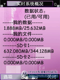

http://moto.it168.com/thread-345203-1-1.html насколько я понял, здесь есть мануал, как увеличить память телефона, до 25.632 MB. Незнаю насколько это полезно, но если это так, то можно в память грузить скины и не мучаться, когда скин стоит с карты и надо её вынуть.Прикрепленное изображение

http://translate.google.com/translate?u=ht...zh-CN&tl=en ссылка на переведенную темку, Asta Roth погляди и дай ответ это реально или нет?
Ezxlocal ezx_user and will be combined, sharing 27 M storage memory.
(method:
1: ezxlocal and ezx_user package to sd card, copy the home directory to sd card;
2: ezxlocal and ezx_user sd card to extract the home directory;IT168
3: ./mkfs.jffs2-d / mmc/mmca1/home-o / mmc/mmca1/35.smg
there are a small cramfs, is a streamlined version of linux system, mkfs.jffs2 is extracted from the inside out.
4: / usr / etc / init.d / mountfs.sh cancelled ezx_user and ezxlocal the mount, only mount / home. )
and digital cameras, document management what the tone of the picture, the original can only use the 12 M ezxlocal space, can now be run out 25 M around.Moto.it168.com6v ' ] 0j.g6u8d
recognized that: jffs2 mobile storage memory does not support the virtual memory swap file format. Therefore, the extra space can not be Create a mobile virtual memory.
Compared with other voice function to delete the brush-Pack, this package is based on the 3 D Daxia 46 P_INFINITY_FULL amended, and increase the kaleidoscope of 320 * 240 camera. A lot of other functions, memory and storage into the real significance of the 27 M, Why not.
will vui folder into the root of the sd card, the voice can be used.
Shuawan to automatically open the opportunity card in the boot logo, Stubbs panels reboot on the use of normal classes. booting the first time it will take longer, because the system format Division of jffs2 need time.I
reset the initial password is:325142 IT168
Langming of speech recognition is another concept that can read the menu more information and am sure that there are relations, the change should also be relatively large.
Langming modify the functions, or should Langming brush on the basis of the amended package more appropriate. font can be relatively large in the original package of brush on the topic of modified to It near normal. I am not good at to the theme of this I am powerless.
can be considered a direct replacement for Langming brush-package the theme for the general theme, and then joined the corresponding decipher, such as the installation of such mpkg. Langming package to interested students can try out
