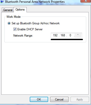

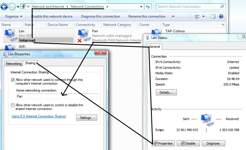

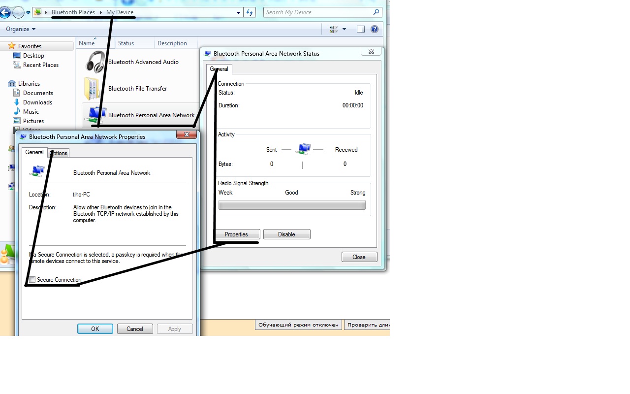

Short English Tutorial
Backup your net profiles /ezxlocal/download/appwrite/NetProfile, and create a fake profile
with ip 127.0.0.1 on proxys items.
Pan is Personal Area Networking, bnep is an implementation of tcp ip protocols over bluetooth.
This soft allow to you surf over internet, msn, etc etc and listen live radio Ex Digitally imported, and download
a .pls file to play the radio you like.
You need a Linuxmod RC1-RC2 with 44r firmware,for the best compatibility.
Well, on windows you need install a bluesoleil software, its create a pan network adaptor, this
device acts has gateway, deselect all options on below images on post, because our dhcp server is
windows not, bluesoliel, enable to icmp and dns options en both adapter, remember one adapter is
ethernet card and other adapter is Bnep.
All this procedure is share internet, read on google how to share your internet, but remember
your gateway is pan adapter.
On Linux you need a some rules for iptables, make a little scripts
/pand --listen --role GN --master --autozap --nodetach
make a script of this
ifconfig bnep0 192.168.0.1 netmask 255.255.255.0
dhcpd3
iptables -A FORWARD -i eth0 -o bnep0 -s 192.168.0.0/24 -m state --state NEW -j ACCEPT
iptables -A FORWARD -m state --state ESTABLISHED,RELATED -j ACCEPT
iptables -A POSTROUTING -t nat -j MASQUERADE
sh -c "echo 1 > /proc/sys/net/ipv4/ip_forward"
configure your dhcp.conf
subnet 192.168.0.0 netmask 255.255.255.0 {
range 192.168.0.2 192.168.0.10;
option routers 192.168.0.1, 10.0.0.2;
the zpand2 translation to english comes on december.
sorry for my english realy sucks.
