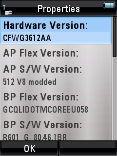

Ok, problem solved!
I have been able to mod a CG36 and flash it successfully to V8, see firmware version in screen shot.
