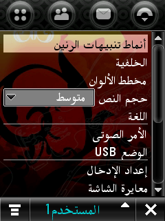

Finally motorola has released an arabic firmware for a1200 "R532H9_G_11.24.06R" ( Wednesday, 28 May 2008 )
and i fixed flip closed mode by that
thanks to motorola
New widget ready firmware is coming very soon by motorola
*Multi languages :english , farsi , arabic , spanish , french , portuguese , chinese , Italian , russian , netherlandish , hebrew
*Message Delivery Report enabled by default
*a1600 skin
*preload full english and touchscreen msn messenger
*preload original motorola 3D game
*new ringtones
*new wallpapers
*english and spanish VR
*realplayer with equalizer
*speed is good
*yan0 startup.txt script
*4GB SDHC
V3.0
*4GB SDHC is now working (not in mass storage mode)
*some improvement in alertstyle
*added dutch(netherlandish) and hebrew(the font is added some options are still untranslated)
*EDGE is working
*Fixed some other bugs
notice 1 : the first startup takes 3~5 min to boot
notice 2: try to setup your photos and videos folder before using the camera
notice 3: for 4GB SDHC try to format by quick and for 8GB by windows( It shows 3GB of 8GB but it's working, It's still on testing)
thanks to mischka , amir and yan0
special thanks to "Xray2000" for netherlandish and "aviram" for hebrew languages

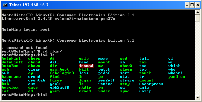

НЕ РАБОТАЮТ РАНЕЕ УСТАНОВЛЕННЫЕ ПРОГРАММЫ!!!
Щас угадаю: из-за /bin/bash smile.gif ...
Добавлено позже (16.6.2009, 15:43):
Ну, судя по скрину телнета shuffle.gif ... И интуиции ...
Добавлено позже (16.6.2009, 15:45):
Ещё root@MotoMing ... Наводит на мысли biggrin.gif ...

если проводить аналогии с твоей прошей, то все бы хорошо, но спицально перепакованные проги не инсталлируются(
