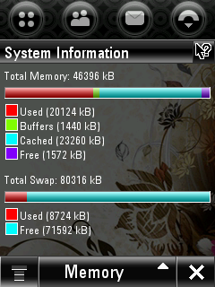

Hi,
for jffs2 I maked a swap partition (with gparted so I resize without lose my data) of 80mb.
Firmware works fine with a swap partition.
So I restored autorun SUI (SysRegistry /usr/data_resource/preloadapps/) at the end I added ;4475774d-dea8-4038-8ea5-4ce4dfcae160
I attach autorun.txt (place inside SD)
I also maked a folder ringtone inside /usr/language/ so I can listen sound when I take screenshot with Assistant.
I attach the folder (you need extract and place in /usr/language/).
We can make easy with samba (before type rw with ekonsole or telnet session).
For font I attach My_FAVOR folder with inside a font (you need extract and place inside "phone"), so you can make some try without change standard font (inside /usr/lib/ezx/lib/fonts).

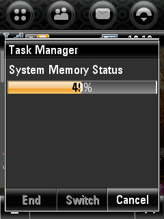

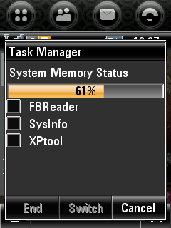

Прошивка: jffs2
Рейтинг: 112.5
I cannot well traslate, but firmware (I'm testing jffs2 version) need swap partition and run fast, also memory it's ok.
Some screenshot with Assistant running for take screenshot and SUI (in autorun).
