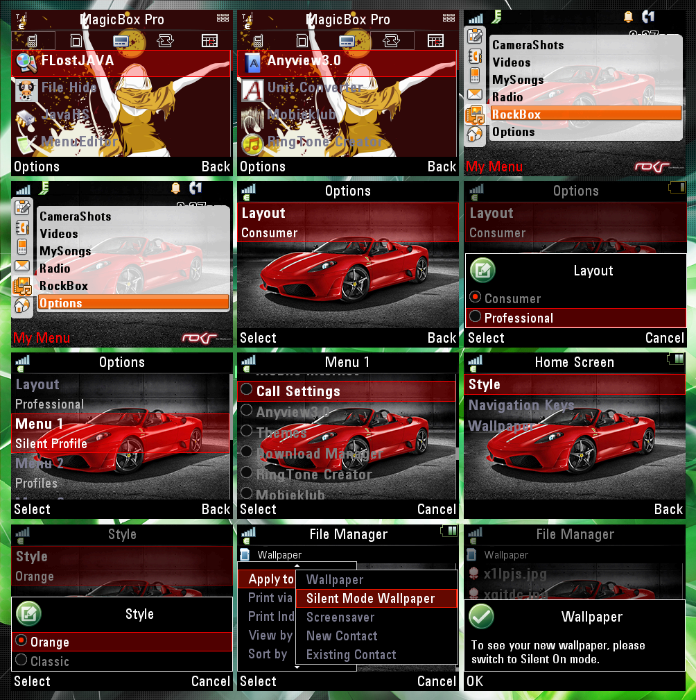

Imperfecto version-3
special thanks to
1. mmus.us & members
2. rasputin 007 ,for punching the basics in me
3. ilove3d ,for all the great applications & help
4. nikhil007 ,for providing many related files & suggestions
- sidebar enabled
- sidebar is a network related app,to activate on your mobile follow this Guide by nikhil007
- happybox back
- all versions of mpkgbox + rockbox
- 20 preloaded mpkg applications
- toggle application to apply any of the happybox item to sidekey
- right soft key replaced with new rkr logo
- shorcuts is now my memu
- device status gives you some basic info about your phone
- have your items on the 5th selection on sidebar, switch from professional to consumer to see the difference,explained in the screenshots
- silent mode wallpaper
- from settings/homescreen switch style to switch on and off the sidebar
- mpkgbox2.0 pro version
- faster inbuilt themes
- plus all the stuffs from previous versions of imperfecto
