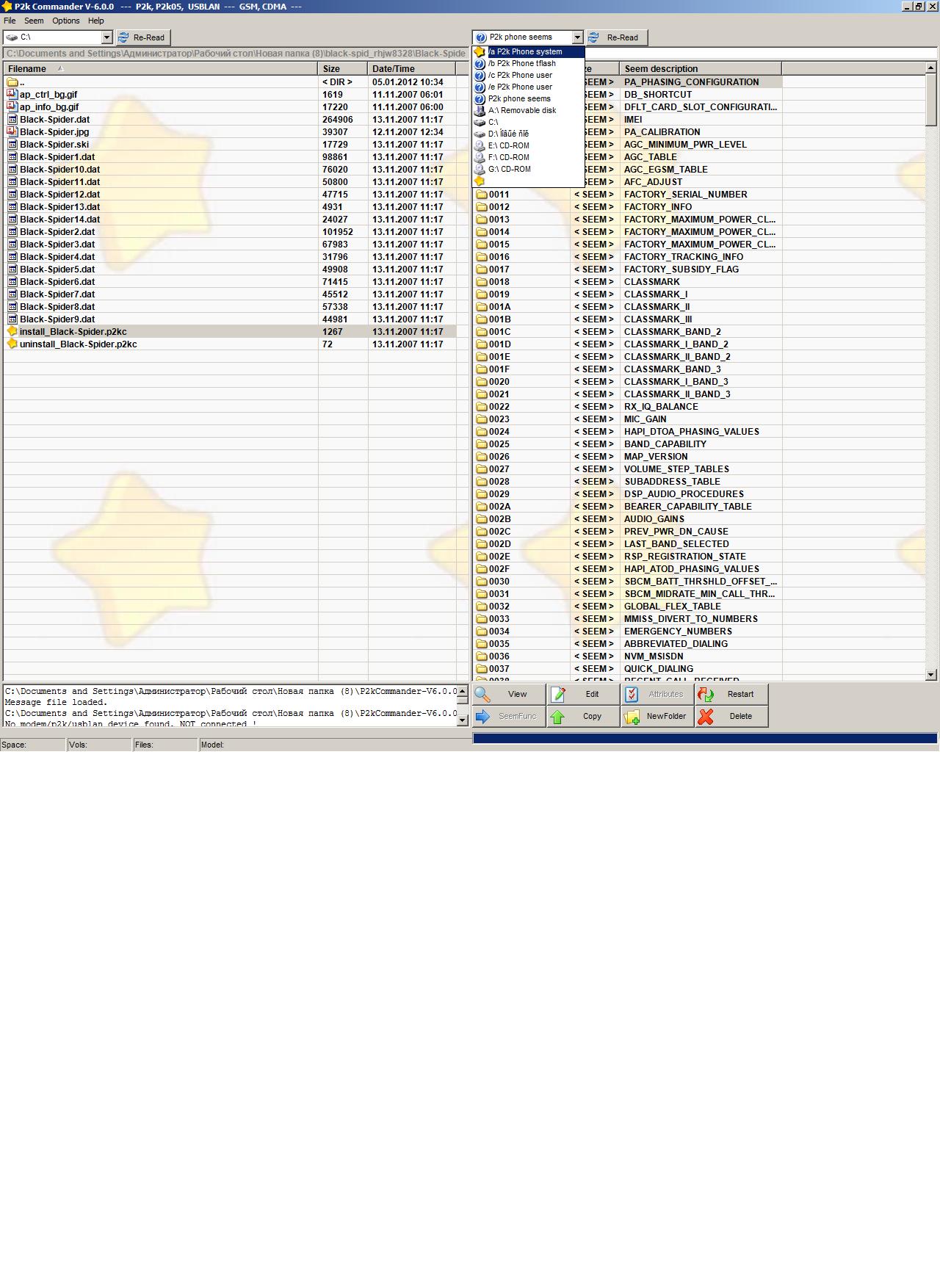

я нашел инструкцию по установке тем тока не могу понять как ставить?
прогу эту скачал есть принт скрин а че и куда копировать непонимаю
1) Download P2K Commander (make sure the archive has the p2kdrivers folder). Unzip and run P2KCommander .
2) Point your Device Manager to the p2kdrivers folder and install the Motorola MCU Data logger, etc... devices.
3) If your skin folder has a 'install_yourskin.p2kc' file, just click it and P2KCommander will install the skin.
4) If the install.p2kc file is missing read below:
- Open P2KTools
- Plug Your Phone on the Cable
* On E398, V635 I sugest take the TransFlash off
- When the status apear 'Connected'
- Hit 'Refresh' to get the file list.
- Select the folder 'Skins'
- Right Click on the folder 'Skins' Will apear a sub-menu
Select the option 'Create Folder'
- Put the Name of the Skin, must be the same name of the '*.ski' File!
- Hit 'Refresh' to get the new file list.
- Select the new folder that was cereated. (The one that contain the same name of the *.ski)
- Hit 'Upload' to upload the skin files to the phone.
- Select all the files with *.DAT and *.Ski Extension
- Hit 'Open' to Upload
- Wait a Minute while P2KTools Send the files to your phone.
- Select the folder 'Picture'
- Hit 'Upload'
- Select the wallpaper and Screen Saver of the skin
Done it, restart your phone and check out your new skin..

родной, на EX300 не придумали ещё, как темы менять
