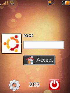

Vinrarus Hello! Reed managed to make it start with the system! Look what I did:
Replaces the file animation (\ usr \ SYSqtapp \ WindowsServer) by z6login (in this package)
But as the animation was made to go out alone, the z6login out too!
You know how to solve the problem? Plz Help me !!!! thank you

Hello vinrarus, the Executioner can gets anywhere, and the rest is in
\ ezxlocal \ download \ mystuff \. system \ LinXtend \ usr \ bin \ z6login
Thanks for responding!
Screens:
