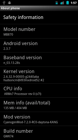

FIXED ISSUES!
init no longer hogs 100% of a core
Bluetooth WORKS!
DSP Manager WORKS!
Torch (flashlight) WORKS!
Google Voice WORKS!
Dock Settings Re-Added
Battery Fix (battery files from 2.3.3)
Both SD Cards work
WIFI and USB Tethering WORKS!
WIFI sleep issue MIGHT be fixed in Beta 2
Updating SU binary WORKS! (After update from Play Store)
