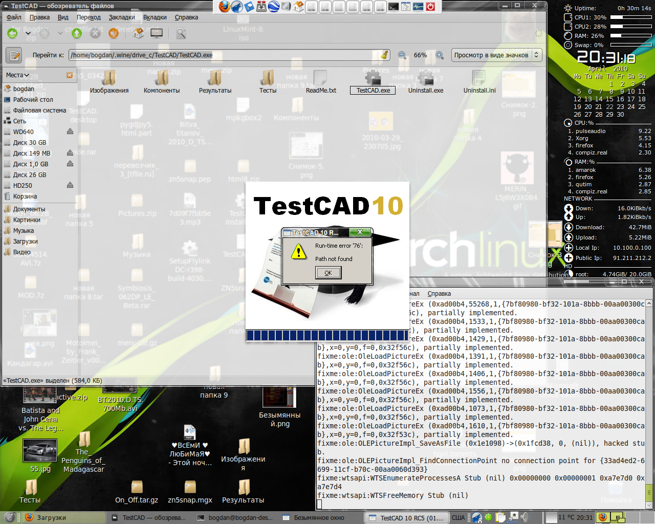

DDA-E398,
под вайном не запускается
bogdan@bogdan-desktop:~$ wine C:\\TestCAD\\TestCAD.exe
err:module:import_dll Library MSVBVM60.DLL (which is needed by L"C:\\TestCAD\\TestCAD.exe") not found
err:module:LdrInitializeThunk Main exe initialization for L"C:\\TestCAD\\TestCAD.exe" failed, status c0000135
Убунтка 9,10,вайн 1,1,31
fixme:ole:OleLoadPictureEx (0xacf1bc,40391,1,{7bf80980-bf32-101a-8bbb-00aa00300cab},x=0,y=0,f=0,0x32fa88), partially implemented.

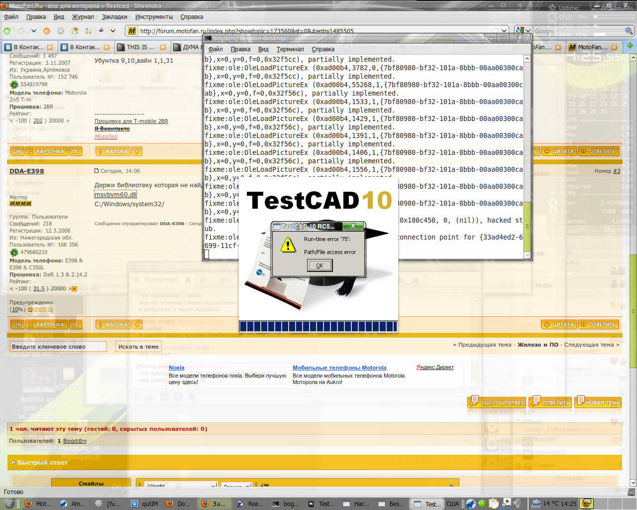

сообщение 22.4.2010, 17:32
DDA-E398,
bogdan@bogdan-desktop:~$ wine /home/bogdan/.wine/drive_c/TestCAD/TestCAD.exe

err:seh:raise_exception Unhandled exception code c0000005 flags 0 addr 0x682f1ae3
fixme:ole:OleLoadPictureEx (0xad00b4,1445,1,{7bf80980-bf32-101a-8bbb-00aa00300cab},x=0,y=0,f=0,0x32f5cc), partially implemented.
fixme:ole:OleLoadPictureEx (0xad00b4,3782,0,{7bf80980-bf32-101a-8bbb-00aa00300cab},x=0,y=0,f=0,0x32f5cc), partially implemented.
fixme:ole:OleLoadPictureEx (0xad00b4,55268,1,{7bf80980-bf32-101a-8bbb-00aa00300cab},x=0,y=0,f=0,0x32f56c), partially implemented.
fixme:ole:OleLoadPictureEx (0xad00b4,1533,1,{7bf80980-bf32-101a-8bbb-00aa00300cab},x=0,y=0,f=0,0x32f56c), partially implemented.
fixme:ole:OleLoadPictureEx (0xad00b4,1429,1,{7bf80980-bf32-101a-8bbb-00aa00300cab},x=0,y=0,f=0,0x32f56c), partially implemented.
fixme:ole:OleLoadPictureEx (0xad00b4,1391,1,{7bf80980-bf32-101a-8bbb-00aa00300cab},x=0,y=0,f=0,0x32f56c), partially implemented.
fixme:ole:OleLoadPictureEx (0xad00b4,1406,1,{7bf80980-bf32-101a-8bbb-00aa00300cab},x=0,y=0,f=0,0x32f56c), partially implemented.
fixme:ole:OleLoadPictureEx (0xad00b4,1556,1,{7bf80980-bf32-101a-8bbb-00aa00300cab},x=0,y=0,f=0,0x32f56c), partially implemented.
fixme:ole:OleLoadPictureEx (0xad00b4,1073,1,{7bf80980-bf32-101a-8bbb-00aa00300cab},x=0,y=0,f=0,0x32f56c), partially implemented.
fixme:ole:OleLoadPictureEx (0xad00b4,1610,1,{7bf80980-bf32-101a-8bbb-00aa00300cab},x=0,y=0,f=0,0x32f53c), partially implemented.
fixme:ole:OLEPictureImpl_SaveAsFile (0x1e1098)->(0x1fcd38, 0, (nil)), hacked stub.
fixme:ole:OLEPictureImpl_FindConnectionPoint no connection point for {33ad4ed2-6699-11cf-b70c-00aa0060d393}
fixme:wtsapi:WTSEnumerateProcessesA Stub (nil) 0x00000000 0x00000001 0xa7e7d0 0xa7e7d4
fixme:wtsapi:WTSFreeMemory Stub (nil)

Bogd@n, удали папку "Изображения" впапке с программой.
Запусти снова прогу и проверь создастся ли она.
Мне кажется зря я функцию автоопределения ситемного раздела использовал...
сообщение 22.4.2010, 18:20
да,создается.

Попробуй запустить вот эту версию. Если загрузится нажми выйти. Какой результат? Папка Picture в корне диска появилась?
сообщение 22.4.2010, 18:56
загрузилась,нажал сразу же выход,папка Пикчерс в корне появилась

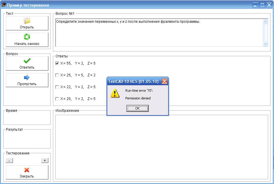

открываю файл Пример тестирования, тыкаю Начать, ставлю галку в первом пункте, жму Открыть, в диалоге выбираю Да, получаю
З.Ы. Просмотрщик ругается на файлы с папки Изображения, что это .bmp файлы с неправильным расширением :)
З.З.Ы. Qt - вещь :)

1. Это поправим к выходным...
2. Да вроде гифы должны быть.
