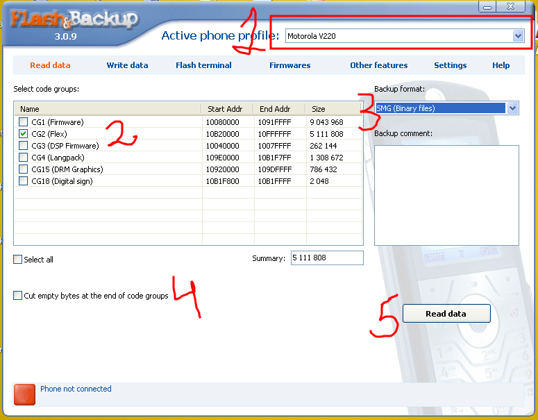

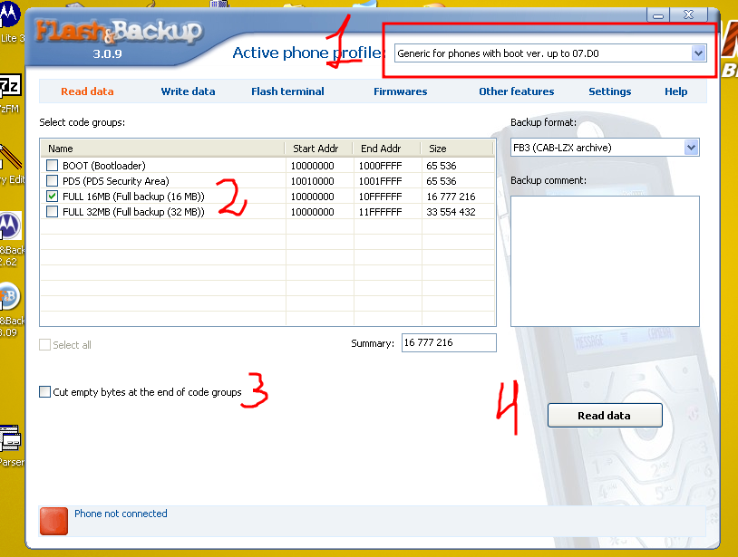

1. It is strongly recommended to dump the entire memory chip using Flash&Backup 3 before any flashing actions.
2. You need to dump CG2 flex separately to get the ringtones. Just open dumped CG2 in the FlexParser04 program to unpack it.

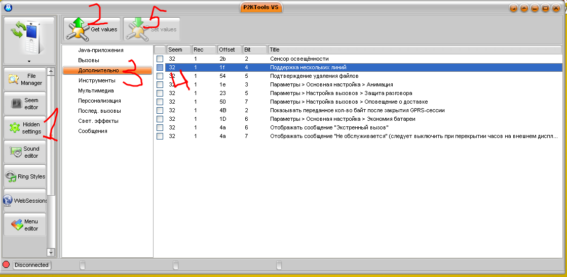

I also noticed after flashing both V8 and V220 that there is 1 missing call icon all the time. Is there any way to remove it?

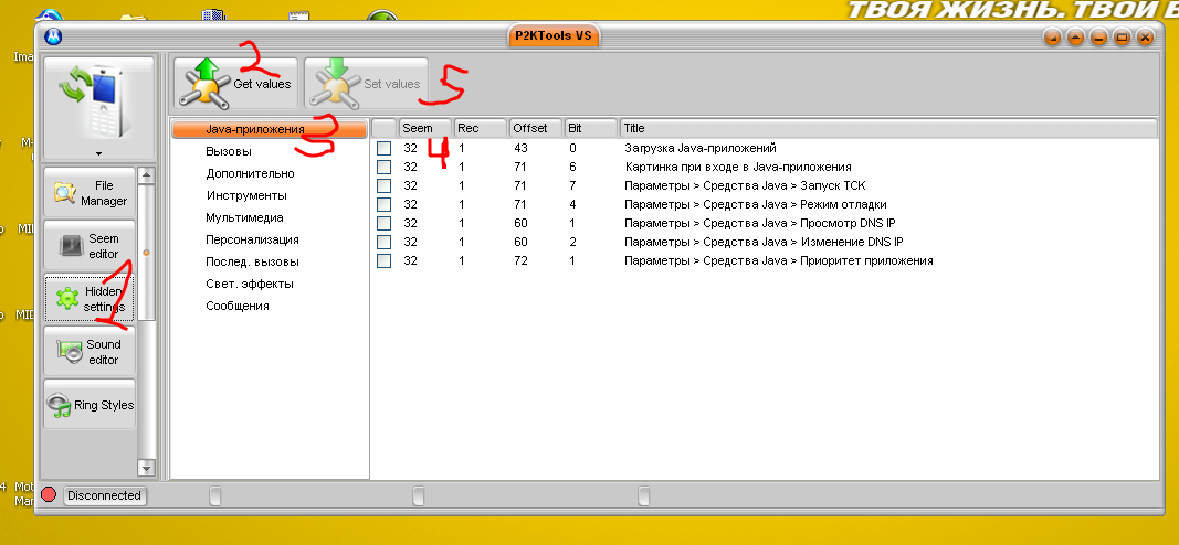

It is not missing call but "active line" icon. Yes, you can hide it using SEEMs editing by P2KTools VS or P2K Advance Editor programs.
Just untick this option there.

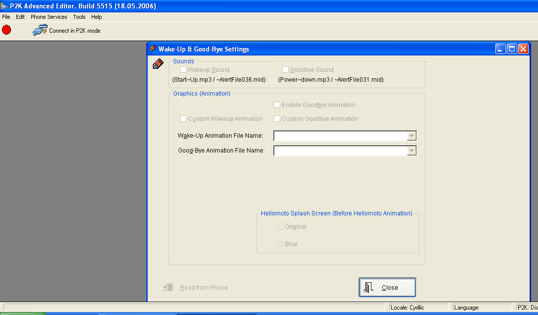

You can customize WakeUp & GoodBye media in the P2K Advanced Editor.
Run P2K Advanced Editor when P2K Tools VS is active then click "Connect in P2K mode" button.
IIRC, you can even change boot splash there but only "Blue" and "Original" variants available. Try to activate "Blue" instead of "Original", perhaps this is old boot splash from previous firmware.
