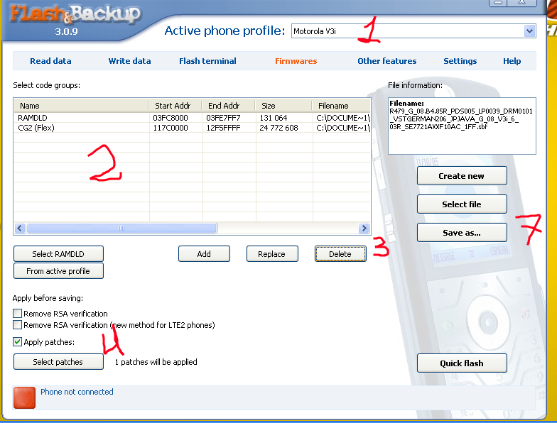

Workflow is something like this:
1. Download any firmware for V3i with the favorite CG2 or CG4.
2. Open shx/sbf file of firmware in Flash&Backup 3 on the "Firmwares" tab with "Select file" button.
3. Delete all code groups except RAMDLR and CG2 (or CG4).

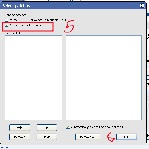

4. Apply "remove SP-lock" patch by tick for removing SIM-Lock from CG2 flex if any.

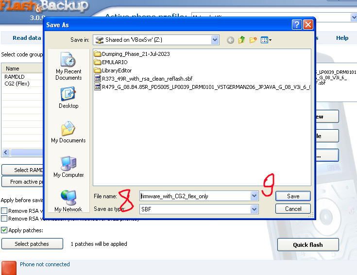

5. Save firmware with CG2 or CG4 only to SBF or SHX format.
6. Flash it using RSD Lite 3.8.
