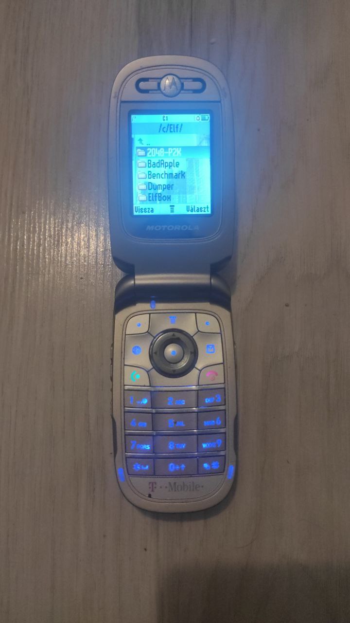

Custom firmware with ported ElfPack v1.0 for the Motorola V235 phone, which uses a Neptune LTE2 SoC and supports EDGE data transfer technology. Indepth6 helped me a lot in creating this modded firmware and testing it, I thank him very much. This is the first available custom firmware for Motorola V235 with the ability to run ELF applications.
The firmware is prepared for phones of the R3512 platform: the only representative of which is Motorola V235 with 128x160 cSTN display and 8 MiB RAM.

Список ELF'ов / List of ELFs:
2048-P2K
BadApple
Benchmark
Dumper
ElfBox
FBrowser
FireEffect
MotoCMD
Neko
Overclock
Perlin
Screenshot
Spout
VibroHaptic
Yeti3D
Yeti3D-Old
