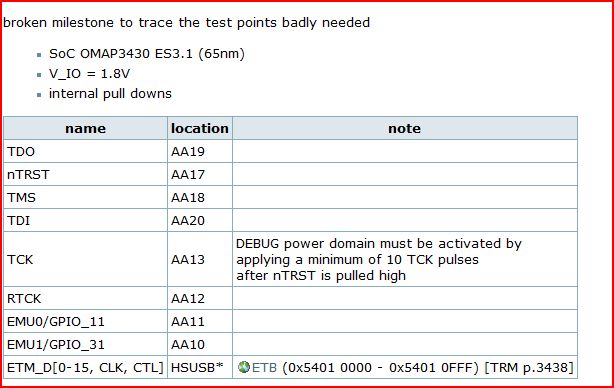

Структура mbmloader'a
Карта памяти

0x5401 0000 - 0x5401 0FFF: ARM embedded trace macrocell (ETM) module
0x5401 1000 - 0x5401 1FFF: Cortex-A8 module
0x5401 9000 - 0x5401 9FFF: Trace port interface unit (TPIU)
0x5401 B000 - 0x5401 BFFF: ARM embedded trace buffer (ETB) module
0x5401 D030: The DBGEM signal on the Cortex-A8 is driven by setting bit 13

jtag

L4 emulation

jtag
