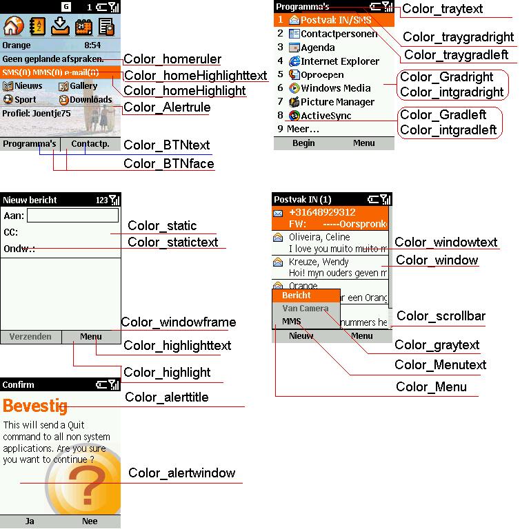

Colour Codes
The next section sets the colours used by the phone- not just for the Homescreen, but also for the Programs menu, the softkeys at the bottom of the phone, and the colours used by most applications. (You may find that some applications use colour codes that aren’t immediately obvious- for example, when looking at the Monthly view in the Calendar, the colours are set by the colours of the softkeys.)
The colours are coded in hexadecimal. That is, a numbering system that has 16 digits from 1 to F, instead of just 1 to 9 (ie; 1, 2, 3, 4, 5, 6, 7, 8, 9, A, B, C, D, E, F, 10,11, 12, 13, 14, 15, 16, 17, 18, 19, 1A, 1B, 1C etc.) Having extra numbers coming between 9 and 10 take a little bit of getting used to (as does the pronounciation- is 1A "A-teen?"), but is really quite simple to deal with once you've got your head round the concept. You might find it useful to create a list or spreadsheet with the "normal" decimal and hexadecimal numbers for converting between the two.
There are 6 digits in the hexadecimal colour codes used by the phone, which work in pairs and correspond to the Red, Green and Blue values (as any colour can be made up of a combination of the three primary colours.) The first two digits refer to the Red component, the second two to the Green, and last two to the Blue. And because the two digits are hexadecimal, that means there are 255 possible values (if they were in boring old decimal, you’d only have 100…) So, for example, #FF0000 would be pure red, #0000FF would be pure blue, #FFFFFF would be white, #000000 would be black.
You’ll probably find that the "pure" colours look slightly unnatural- for example, if you find #FF0000 (for example) to be too bright for whatever you're after, then bring the code a bit closer to black. As black is #000000, just bring down the "FF" part of the code- for example, you could try dropping it to "A0", so the code would be #A00000. If it's too dark, then bring the other values up to bring it closer to white- for example, #FFA0A0 would be a light pink.
(It's worth noting that these colours don't mix in the way you are probably used to- that is, the way paint mixes- this is because the colour of a paint is determined by the light it absorbs, whereas with these colours, you're effectively mixing the actual light itself.)
If you’re trying to find the code for a specific colour- for example, if you're trying to make your colour scheme match with a colour from your background image- but you don't want to spend hours tweaking colour codes, then it’s no problem;
1) Open up the image which whatever colour you’re after is in with Paint (as standard as Solitaire on Windows machines.)
2) Zoom in (so that you can be sure you’re going for the exact pixel you want to match the colour of), select the "dropper" tool, and click on the colour you’re after.
3) Then go into the "Colors" menu, and select "Edit Colors", and click on "define custom colours." The colour you’ve selected will be the one that comes up, and the Red, Green and Blue component values will be displayed on the bottom right hand side- just convert these values to a hexadecimal number (explained above) and put them into your colour code.
One final colouring tip- if you want your colour scheme to be used by other people, then avoid using Red and Green on each other (eg. red text on a green background) as that is the most common pair of colours that colourblind people (like me...) have in distinguishing from each other.

P.S.
Это "библия" от Микрософта. Читать, правда, тяжело... Но при желании - можно.
