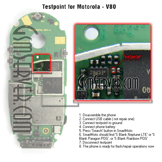

Please, my V80 is dead and I have to apply hard reset, but I don't how exactly I have already read all what I need to do !
But if any one can make PICTURE"S" step by step I'll be thankfull rolleyes.gif

There is picture with V80.

i don't want just the test point ! I know already where is it !
I need a draw may be !

Motorola_Angel,
Close 4 and 5 contacts (to consider on the right to left, from the opposite party from pws input) on a socket, insert the battery, press power

Motorola_Angel, on your mobile phone, on the cable plug (the place where you insert the cable) - count from right to left 4th & 5th contacts.... cross them (close, join...) with some metal wire... and then plug the battery into the phone and press power button. As i can see english is not you native language... so if you don't understand - we can't help you....

now my phone is connected as flash neptune, but every firm I se don't work on it !
