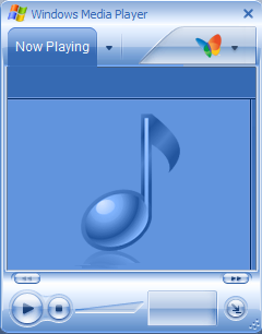

Spasibo Semenigor !!!
Zabiraem variant Light Player so Skinom Windows Media Playera !!!

Цитата(WBaNW @ Среда, 9 Августа 2006, 20:57)
Zabiraem Skin Windows Mobile !!! + Animaciya zagruzki i viklu4eniya + zvuk zagruzki (kopiruem v a\mobile\system) Predvaritelmo delaem backup)
Vse provereno i rabotaet problem ne zame4eno.
LUDI KOMU NE TYAZHELO SKAZHITE SKIN NORMALNII VISHEL ILI NET ??? starwars_draka;
