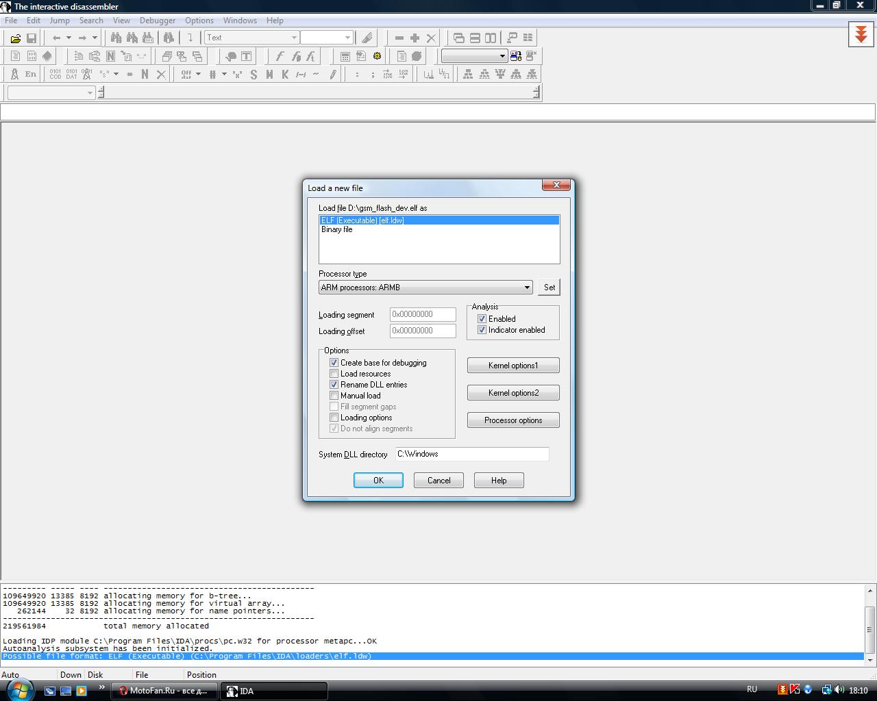

сообщение 27.8.2009, 14:41
download file https://motofan.ru/firmware/?action=view&am...5&parent=17
download programm IDA Pro Advanced https://motofan.ru/soft/?action=view&id=246&parent=5
Load file -> ELF (Executable) -> ARMB
https://forum.motofan.ru/index.php?act=Attach&type=post&id=149103
time of the first analysis is equal 10-12 hours . Depends on force of computer
