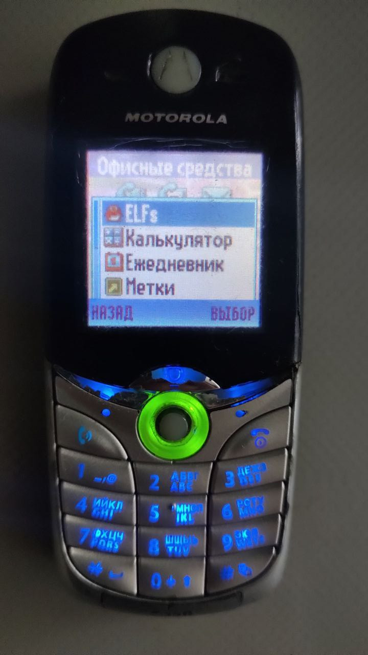

04. CG2, CG4: Mobile QQ menu item was activated and renamed to ELFs.

04. CG2, CG4: Активирован Mobile QQ и переименован в ELFs.
