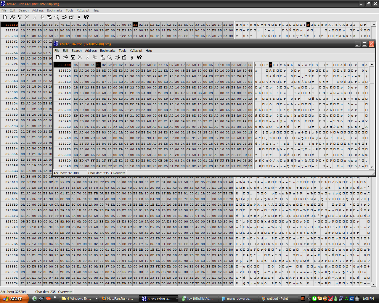

Hey guys I have tried to patch the powerdown menu and it just restarts the phone. Is there any other seems edits I have to do to get it to work?
I remember seeing a list of the patches and what to do with them. Just don't remember where. I know on the usb charge instead of animation you have to do a seem edit and an edit to the dnp. Any help would be great, Thanks.

Well I am trying to port it to H6 now and All it does is reboot. I am lost, LOL.
I think it has something to do with the first code. The fourth offset in the code is different but everything else is the same. In 0dr it is a T and in the H6 it is a 5? Anyone know what I should do?

Bud
read this : PATCHs. Патчи и все для них
or try this ( i have no R452H6 to check )
CODE
[Patch_Code]
001BB044: EA000002E1A0C00C
0058E300: 20EC010030053300F4FFF9E3210046C0
0041617A: 46C046C0
004FA2B1: B5FF1C061C0D2400F592FA601C0721004808F7D4FAC9204A5D402801D1086A381E412903D8041C04230022012165E089E0A40000000006E3
004FB0E0: 2C01D0062C02D00A2C03D00C2C04D113E00D2201208F01003007AB08E00A2001F000F8BEE00820E901003001E0022020020030BDF592FAAD20002100BCFFBC084718
004FB1C4: 47780000E59FC000E12FFF1C100AE96F

Bud
сообщение 21.6.2008, 19:10
Сообщений: 25
Регистрация: 6.6.2008
Пользователь №: 174 217
Модель телефона: Rizr Z3
Рейтинг: 5.5
It gives me an error everytime I try to patch it. So it is no good to use. Good try though anhvu!
