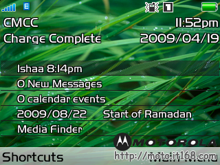

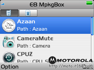

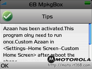

Azaan.mgx By xianyuhui
This feature is only activated once.After the reboot , the main screen - customise the main screen feature is provided !!
Добавлено позже (8.8.2009, 18:34):
прога взята отсюда http://www.mmus.us/forum//showthread.php?t=6924
