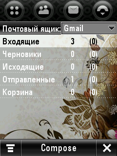

email problems?, explain. For me it is a paid service and I don't use but I can do the tests. Please try attachments setting gmail.
(26.11.2009, 23:28):
I maked a quick test with gmail. I can send and receive sms smile.gif please make a try (for me working fine).

I start Email. Window appears: "This message has been removed or deleted" And.
If the contact on address book. List of outgoing, incoming, missed-only number. Outgoing,Incoming call-only number. if SIM- OK(Showing Name)

I had never before used email with A1200.
I only try to send and receive messages with Gmail with A1200 and it works.
Make the tests, I do not use email with phone (but if there are problems it is easy to solve).
I do not see this window. Only message "This message has been removed or deleted". The program does not start

Телефон при входящих звонках не распознает имена контактов из справочника. Но он понимает номера из симкарты.
В списке входящих-исходящих вызовов, ситуация аналогична
A phone in an incoming calls not recognizes names of contacts from addressbook. But it recognizes numbers from SIM-Card. In the lists of received/sended/missed calls observed the same situation.

@Miroschnik
hi,
Have you solved the problem?
Try copying main.db attachment (inside /ezxlocal/sysDatabase/).
Let me know.

Hi marcolnx !
I copying main.db attachment (inside /ezxlocal/sysDatabase/).
Now all is well.
Thank you!
Скачал прикрепленный файл, перекинул в inside /ezxlocal/sysDatabase/)
Теперь все стало в норме и даже почта!!!!
Спасибо! Но почему так было?
