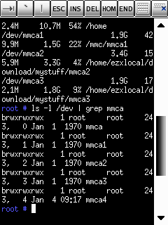

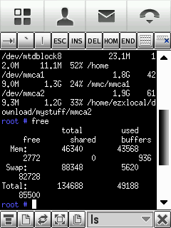

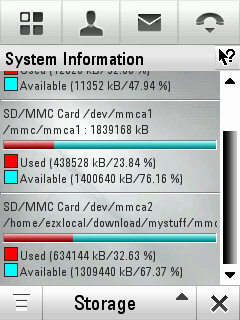

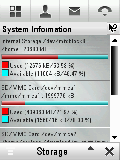

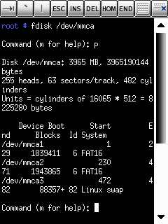

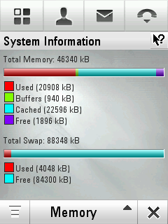

About swap:
If we need 32mb swap just extract the folder .bin from here and put in the root of SD:
http://www.4shared.com/file/84649109/509f6517/Swap_SD.html
You can easy activate - deactivate with Assistant and check with SysInfo or eKonsole

Kernel sdhc:
I compiled the kernel (source 38P_CLEAN) without support SDHC and it works (a message "launching webcam when you change USB mode, etc.).
I compiled the kernel with support for SDHC and show SDHC memory but fails showing file system corrupted message (a message "launching webcam when you change USB mode, etc.).
Now I'm waiting for a response from epinter for the source LATAM (custom ezx.h).
Unfortunately no response from tmp_do (asked many times help).
Unfortunately tmp_do config is no longer available for download.
Unfortunately, little information and little my experience in kernel configuration A1200, but I try to do, ask for help and thank you if someone can help.
If I get the results I want to share with you.
I compiled new kernel for sdhc.
Works, I only need test and fix a little problem (after reboot if you select memory card, one message asking for format, so if you select format (not quickly), after this you can browse sdhc (p.s.: there is not format).
Maybe fixing fstab or ..., just compiled...
May be great our help for testing.

Hi OFN,
Here I attach new kernel (please consider now I maked and now I'm testing, and nobody helped... and I'm not tmp_do).
I'm waiting epinter help for LATAM kernel, but waiting for this I maked some try with 38P_CLEAN source.
Because every time click memory card a message asking format... I formatted with linux gparted my sdhd 4gb for:
1,8 gb fat16 (so /dev/mmca1)
1,9 gb fat16 (/dev/mmca2)
80 mb swap (/dev/mmca3)
After this I maked under "phone" a folder mmca2 and maked autorun.txt for testing (maybe later I will update fstab).
- No widgets
- Now I'm testing edit Iris apmd (I replaced). It's the same posted from Novin?

tested with my 8Gb SDHC card
all works
Thanks

Флешка у меня разбита на 2-е части
FAT16 і EXT3
ext3 раздел пока не видится
Про зарядку от компа, на экране пишет что заряжается, но так ли это не знаю.
Добавлено позже (3.1.2010, 14:46):
после редактирования fstab и autorun.txt второй раздел заработал
