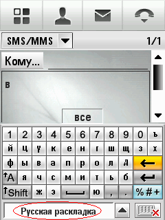

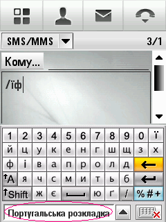

I would like make an update with 2 standalone keyboard for russian and ukrainian.
I maked all, but now I'm at work (so only win) and qmpare cannot open lib_uk-ua.qm for edit.
I will try later at home.
If you can (I need translate for ukrainian and russian) please edit lib_uk-ua.qm and lib_pt-br.qm replacing the string France keyboard for Russian keyboard and Portuguese keyboard for Ukrainian keyboard.
I already changed lib_ru.qm and lib_fr-ca.qm for russian (please check).
I would like also add iTap ukrainian (we can ask for this in Z6 forum?).
I attach the folder with the files inside, so we can test.
Thanks for testing.
So for Russian under input setup:
1st language Russian(fr)
2nd language English
For Ukrainian:
1st language Ukrainian(prt)
I also correct ukrainian keyboard for / (replacing au)
We can please edit lib_uk-ua.qm removing Portuguese (add Ukrainian) and France (add Russian) for keyboard?
Thanks
