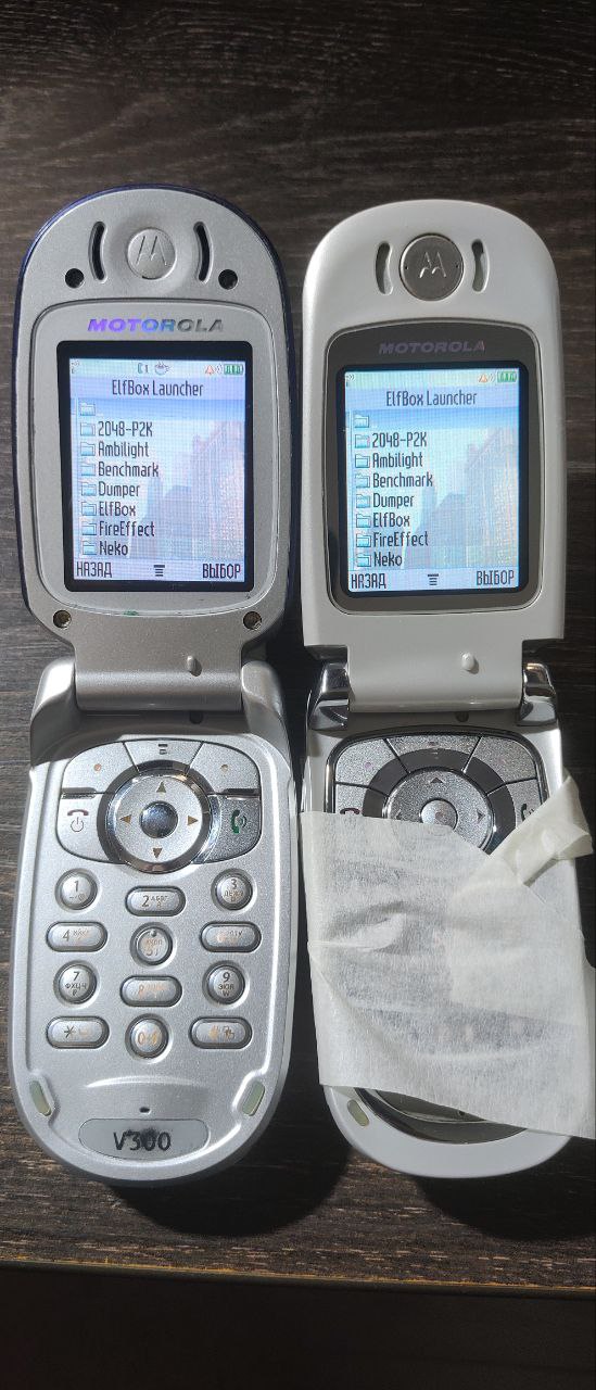

I decided to finish the work started by fkcoder on porting ElfPack to old Motorola phones on the TRIPLETS platform, which were released back in 2003, a whole 21 years ago! As a result, I ended up with a small custom modified firmware, in which I tried to preserve the stock and original design. In fact, the firmware is the first for these phones with a full-fledged ElfPack v1.0.
The firmware is prepared for TRIPLETS platform phones: V300, V303, V400, V500, V501, V525, V600 and some others with 4 MiB RAM.

A description of ELFs can be found in the ELFs by EXL: Nostalgia of development for Motorola P2K.
Attention! Some ELF applications require a running and minimized any Java application.
