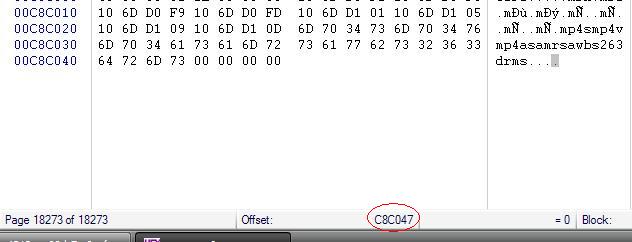

Hello, I'm trying to port patches, I'm trying to port from ACR V360 to E0R, and I've read a guide partially translated to english, but I'm not sure about a few things, I hope you can help me. I've read I should indicate Binedit which firmware I'm working on, and I saw this example:
QUOTE
Bin ID="R373_G_0E.30.49R" adr="0x98F828" base="0x0" TYPE_ARM="BigEndian"
SaveDataBin Enable="Y"
RemapBlok Start="0x0" Len="0xDCE000" Goto="0x10080000"
RAM_Area Start="0x12000000" Len="0x800000"
How do I get this for V360 E0R firmware which I'm porting to and ACR V360 which I'm porting from?

сообщение 8.4.2009, 8:18
Сообщений: 712
Регистрация: 13.7.2005
Из: Кузнецк
Пользователь №: 46 099
Модель телефона: Е398, L9, Z6, V6
Прошивка: разные
Рейтинг: 283
Bin ID="" adr="R4513_G_08.B7.E0R" base="0x0" TYPE_ARM="BigEndian"
RemapBlok Start="0x0" Len="0x15ADFFF" Goto="0x10092000"
TYPE Name="state_entry" Maska="long"
Len="0x15ADFFF" - это длина твоей CG1 в hex
adr="R4513_G_08.B7.E0R" это название CG1 R4513_G_08.B7.E0R.bin
Сообщение отредактировал Umka85 - 8.4.2009, 8:20

Thank you, but I'm afraid it's still not clear... How do I know the length? For example in ACR, how do I know the length? Sorry I don'twant to be asking this the next time. Thank you!
Сообщение отредактировал braian-k - 8.4.2009, 17:16
Umka85
сообщение 8.4.2009, 18:27
Сообщений: 712
Из: Кузнецк
Прошивка: разные
Рейтинг: 283
В BinEdit или WinHex открой CG1 и посмотри адрес последнего байта
braian-k
сообщение 9.4.2009, 6:14
Сообщений: 36
Регистрация: 10.2.2008
Из: Argentina
Пользователь №: 163 127
Модель телефона: V3i
QUOTE(Umka85 @ 8.4.2009, 15:27) *
Sorry man for my stupid question again, but please look here:
IPB Image
I did what you said, I opened my CG1 with winhex and went to the last byte, but, wasn't that supposed to be the address? That's my E0R CG1, why this address is not the same than the one you gave me? if not there, where should I look? Would you explain it a little more? Really sorry for asking again, I still don't understand... I'm confused...
Offtopic: is there a thanks button?
