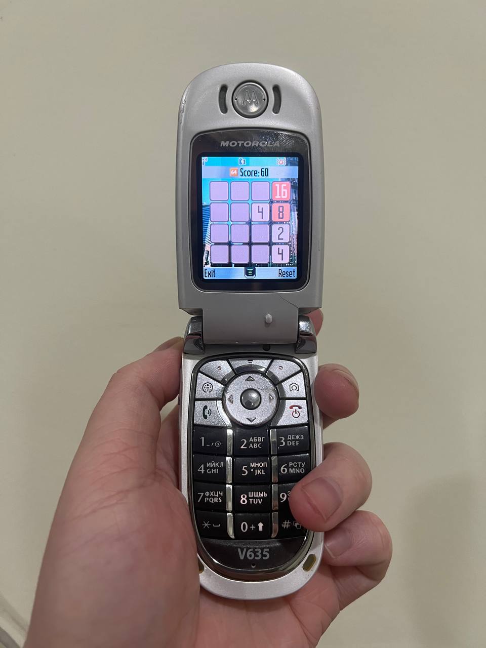

21 years after the Motorola V635, the flagship of the P2K/GSM platform, was released, fkcoder and I, along with the guys from siepatchdb@c.j.r, decided to add support for running ELF applications to it! As a result, we have created a small modified firmware where I tried to preserve the stock and original design for nostalgic purposes. In essence, this is the first custom monsterpack for Motorola V635 with a full-fledged ElfPack.
The firmware is prepared and suitable for all V635 phones of the R474 platform on 07.D0, 07.E0, 08.20, 08.21 bootloaders with 8 MiB RAM and 32 MiB ROM flash memory. Warning!: If you have a 08.29 bootloader on your V635, you need to either downgrade it or rebuild the firmware with RSA bypass patches specifically for the 08.29 bootloader, you can ask for details in this thread. The custom firmware was not prepared for 08.29 due to its low prevalence.

A description of some ELFs can be found in the ELFs by EXL: Nostalgia of development for Motorola P2K thread.
Attention! Some ELF applications require a running and minimized any Java application.
