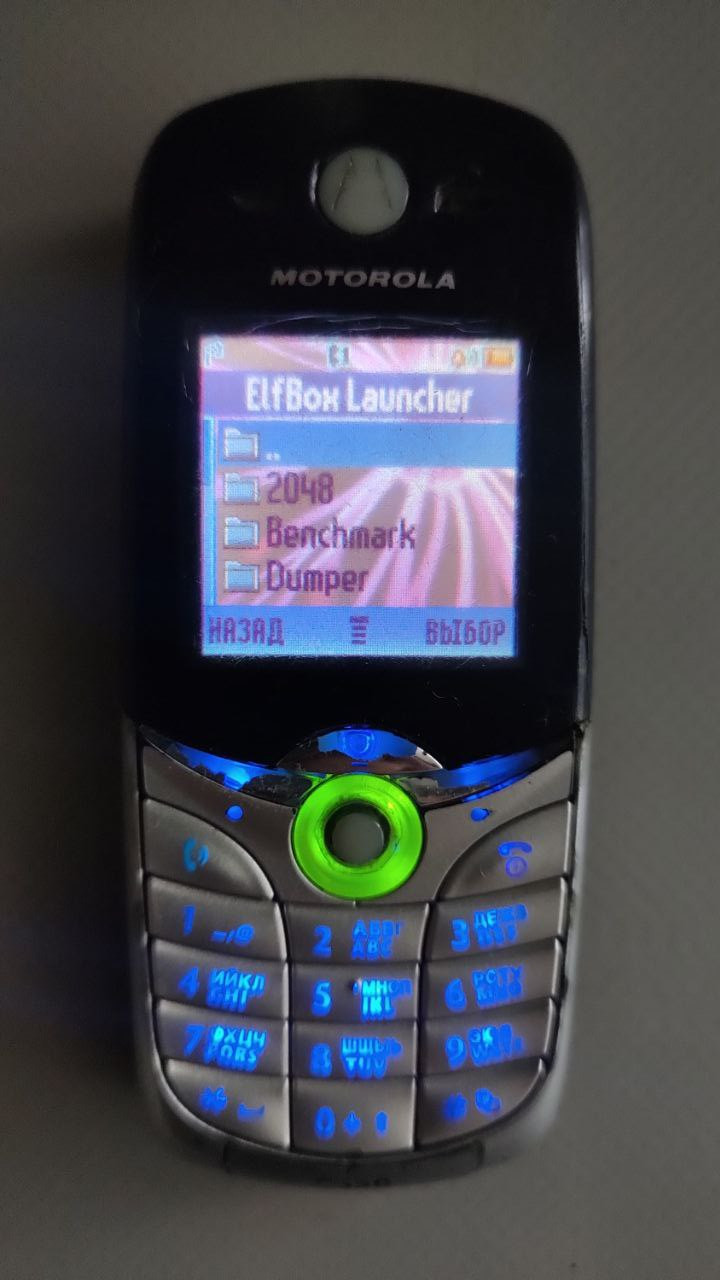

20 years after the release of the low-end mobile phones Motorola C380, Motorola C650, Motorola V180, and Motorola V220, dimonp25 and I, along with the guys from siepatchdb@c.j.r, decided to add support for running ELF applications to these phones! As a result, we have created a small modified firmware where I tried to preserve the stock and original design for nostalgic purposes. In essence, this is the first custom monsterpack for these phones with a full-fledged ElfPack.
The custom firmware is prepared and suitable for phones on the R365 platform: C380, C650, V180, V220, and some others with 4 MiB of RAM and 16 MiB of ROM. The V180 and V220 flip phones will require uploading SEEMs and vibration WAV audio files in the case of the V220, which can be downloaded in this archive.
S/W: R365_G_0B.D3.08R

A description of some ELFs can be found in the ELFs by EXL: Nostalgia of development for Motorola P2K.
Attention! Some ELF applications require a running and minimized any Java application.
